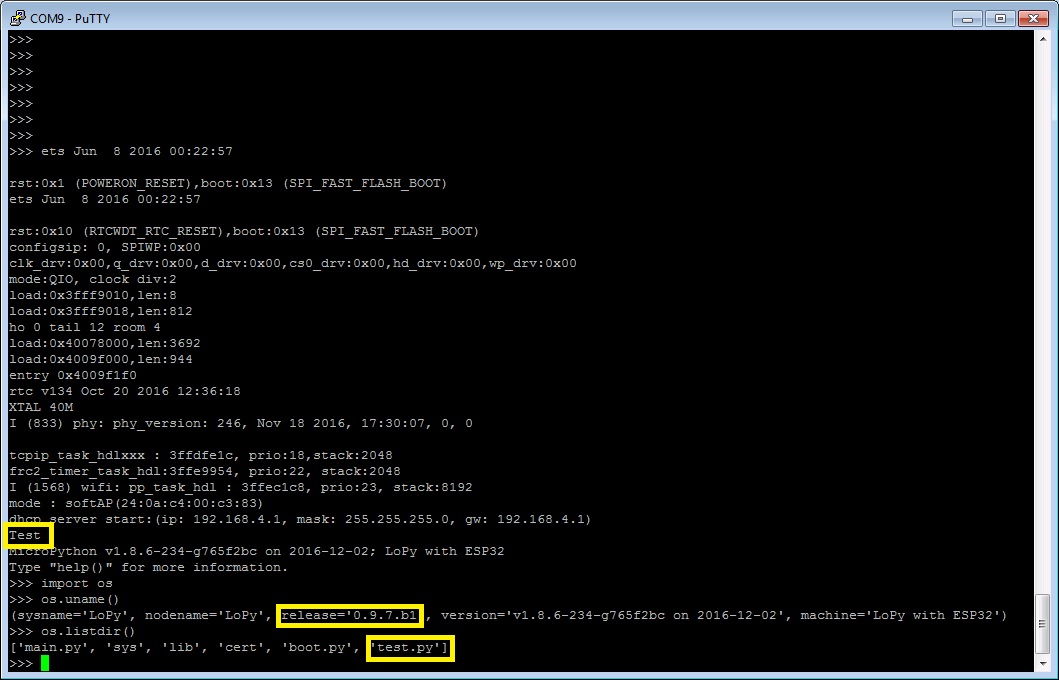

<p dir="auto">OK, as I promised I've tried my LoPy with <a href="http://boot.py" target="_blank" rel="noopener noreferrer nofollow">boot.py</a> as below:</p>
<pre><code>import machine
import os
uart = machine.UART(0, 115200)
os.dupterm(uart)
machine.main('test.py')
</code></pre>
<p dir="auto">with <a href="http://test.py" target="_blank" rel="noopener noreferrer nofollow">test.py</a> file:</p>
<pre><code>print('Test')
</code></pre>
<p dir="auto">and everything is working as it should.</p>
<p dir="auto"><img src="/uploads/files/1481018401986-main-resized.jpg" alt="0_1481018401638_main.jpg" class="img-responsive img-markdown" /></p>
