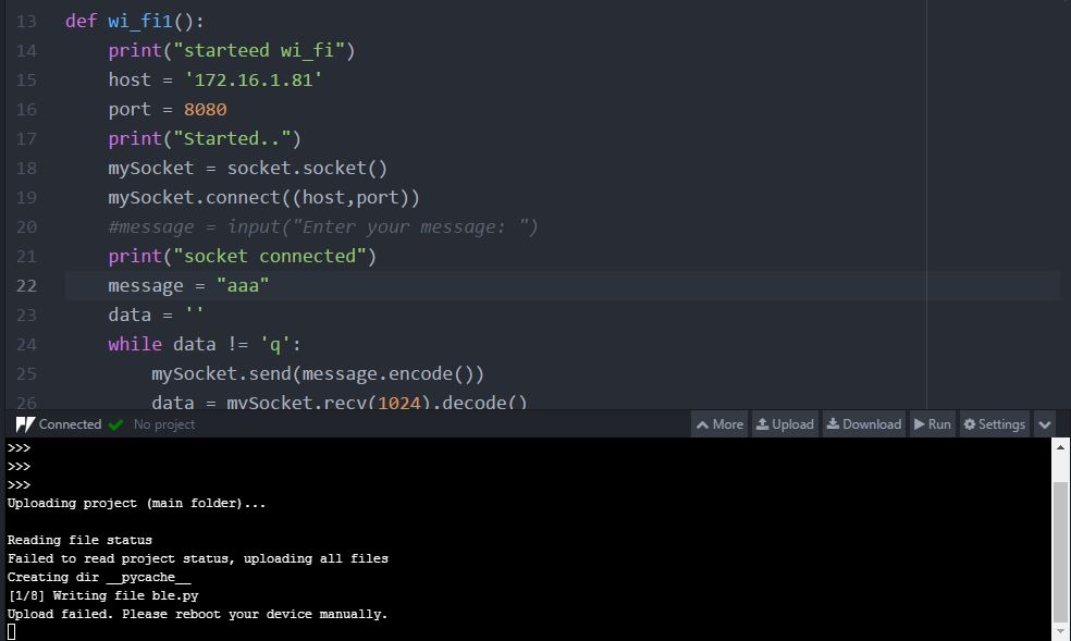

      Could please anybody help me iam Upload Failed: Please Reboot your device manually error . I have to upload project into the LoPy iam getting this error.
      What is the problem. So please replay me!!!!!!

        This is an issue with the current firmware which we are aware of and actively working to resolve, there should be a fixed firmware within a few days. The current work around is to downgrade your LoPy firmware to version 1.9.2.b2. Instructions on how to do this can be found here: https://forum.pycom.io/topic/517/downgrading-firmware-advanced-users
