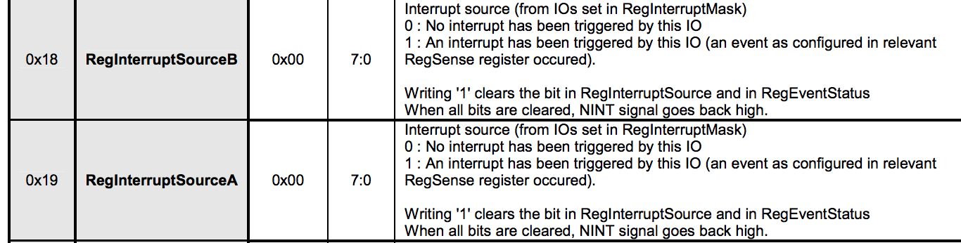

      I'm working with SX1509 peripheral.
      Based on this value '00000000 00000110' from 0x18+0x19 I know that pin 01 and pin 02 caused an interrupt. Now I need to read IO state for pin 01 and pin 02.
      Below code works, but can you suggest improvements?
      def digitalReadFromInterrupt(self,interruptSource):
              readResults = []
              for i in range(15,0,-1):
                  if interruptSource & (1<<i):
                      readResults.append([i,self.digitalRead(i)])
              return readResults
