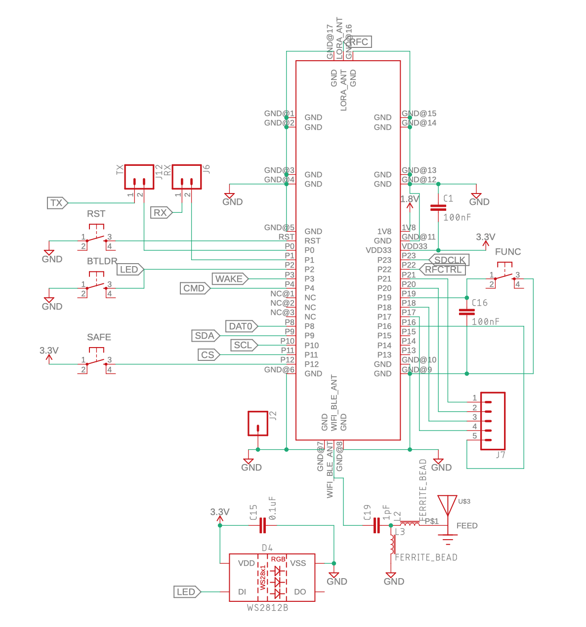

      I am currently trying to integrate an L01 OEM module with an accelerometer and an SD card for logging, however the SD card I am using refuses to work on the OEM - throws a OSError: the requested operation failed.
      I tried the same card on an Expansion board 3 with a LoPy and it works absolutely fine. I've triple checked my connections and everything looks good, I even tried experimenting by pulling the data lines up with 10K resistors and still nothing. I get the error after running sd = SD().
      I even tracked down the pin connections on the expansion board with a multimeter and they are exactly the same as my custom PCB.
      Below is my schematic. I'm following the pins from the official docs - https://docs.pycom.io/firmwareapi/pycom/machine/sd.html
      Wasn't sure what to do with CS so I added a connection just in case.
      Any help is very much appreciated!

        I made a homebrew board with extactly these connections for the SD card, and it works. CS is not required and is in my case floating. I added a 100µF capacitor close to the SD card at the board between Vcc and GND, just to be sure, but I am not sure whether it is needed.
