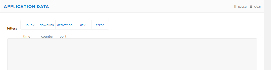

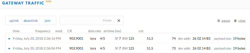

      Right now I can see the uplink data in gateway data traffic, and also the device status shows it's connected. But there is no data in application data page.
      The status of TTN page shows below:
      1. Gateway traffic
      2. Device overview
      3. Application data:
