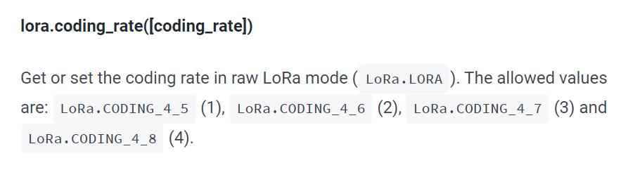

      Which is equivalent to a coding rate of 4_5 according to:
      So far so good, when I try to change the coding rate to 4_8 the coding rate shows Coding rate: 4 when I run my code.

        @asb Scroll down a bit in the documentation page you linked to:
        In LoRa.LORAWAN mode, only adr, public, tx_retries and device_class are used. All the other params will be ignored as they are handled by the LoRaWAN stack directly.
