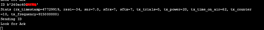

I don't quite understand the lora.ischannel_free() function. The first code below is my main "sending node". I then send it to a reciever which is using the second code. It works fine without the lora.ischannel_free(-120) condition, but when I use it it never actually sends. I only have one sending so I would not think it is busy. The rssi value is like -40.
from network import LoRa import socket import time import pycom import binascii import machine from machine import UART #NODE B # Please pick the region that matches where you are using the device: # Asia = LoRa.AS923 # Australia = LoRa.AU915 # Europe = LoRa.EU868 # United States = LoRa.US915 lora = LoRa(mode=LoRa.LORA, frequency = 915000000, region=LoRa.US915, tx_power = 20) s = socket.socket(socket.AF_LORA, socket.SOCK_RAW) s.setblocking(False) pycom.heartbeat(False) pycom.rgbled(0x007f00) # green receiveFlag = 0 while True: time.sleep(8) pycom.rgbled(0x0000ff) # blue id = binascii.hexlify(machine.unique_id()) data = lora.stats() print("Stats %s" % data) if (lora.ischannel_free(-120)): s.send("ID: %s" % id) print("Sending ID") pycom.rgbled(0xFF00ff) # something... while (receiveFlag == 0): pycom.rgbled(0xFF0000) # RED data1 = s.recv(128) print("Look for Ack") if (b'%s' % id) in data1: receiveFlag = 1; s.send("ID: %s" % id) time.sleep(1) time.sleep(1) pycom.rgbled(0x00ff00) # green receiveFlag = 0

Here is it working...
