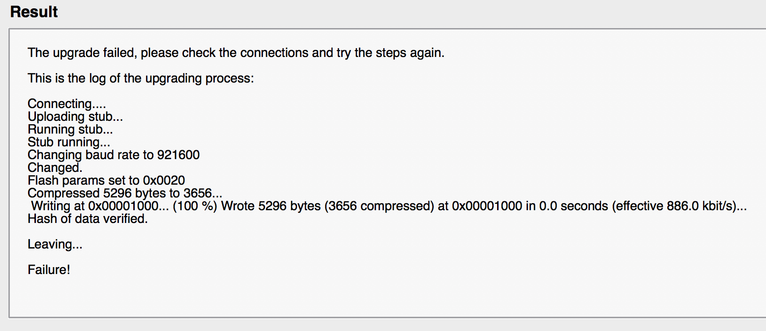

  • @jmarcelino Brilliant - thanks for the explanation, and the advice - it's back to life :-)
    Given how rapidly new firmware versions are coming out, I want to keep the ability to upgrade the module after building it into the rest of the project. Does this mean I'm going to need some kind of switch or jumper to disconnect the serial input from pin P4 during programming? Are there any other pins I need to be careful of?
    Thanks,
    Pete
  • @Pete
    Yes, think of Micropython as an application that runs on the board (which then runs your script). That's what makes it blink, show up as an AP etc. If the Micropython application is broken the board will appear to do nothing (though it might print some debug strings to the UART). However you can do an "upgrade" to reinstall the application again.
    When you connect G23-GND and reset you're telling the board to boot into a special download mode where it accepts a new application image (in this case a new Micropython build). This functionaliy is deeply hardcoded on the ESP32 processor so you'd struggle to break it, especially just by doing a regular upgrade.
    What does break the process are devices connected to pins with special functionality known as 'strapping' which - much like G23 to GND - set different boot parameters. I think your GPS could have been interfering with these.
    I think this new log does suggest the board is communicating.
    Since the error was on setting the connection speed can you now try again disabling the high speed option again?
    If it still fails can you close the upgrade tool, open a serial terminal application on the board's serial port (at the usual 115200bps) and let us know what messages show up after a reset?
  • @jmarcelino No, like I said it's just on a plain breadboard with nothing but power. I was trying to just see it boot before making a further attempt to upgrade it.
    Based on your suggestion, maybe if the firmware is half-hosed then another upgrade attempt could work even if normal booting doesn't. So I've just tried it again with the following result:
    Does the "Stub running" part mean it did actually manage to talk to something on the board?
    Pete

  • @Pete
    Do you still have the GPS plugged in and have you tried to update again without it?
